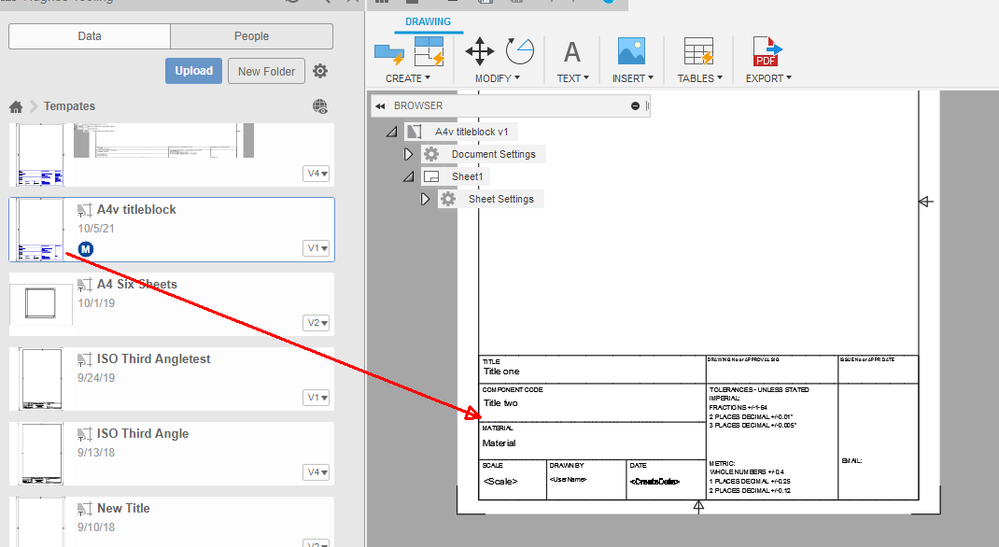

@ClintBrown3D  I have some templates I create for some of my customers that used an imported DWG file. The tile block is coloured blue and still shows blue in the browser but changes to black when opened, not sure when this changed. Also see the problem with existing drawings.
Here you can see the template has the colour removed when opened. I've attached this template.
And here the same happening with an existing drawing.
EDIT. Note if you create a new drawing and use the attached temple it will have the blue title block. The problem only shows it you try editing the template or when you open existing drawings. I can export a new template from a newly created drawing and the new template has the blue title block when edited.

Thanks for bringing this to our attention. It is something we are aware of.  We are monitoring reports (including this one).
The new Object Properties project is the reason that the title blocks are being turned black. Customers who created coloured title blocks in AutoCAD and imported them in, are being affected.
