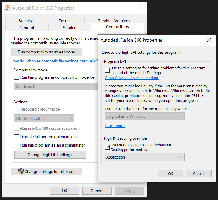

Try to change Fusion's Compatibility settings like in the attached screenshot. I tried to remove the tick on the "Override high DPI..." option and Fusion got blurry again. Which leads me to believe that changing the settings as mentioned should help.

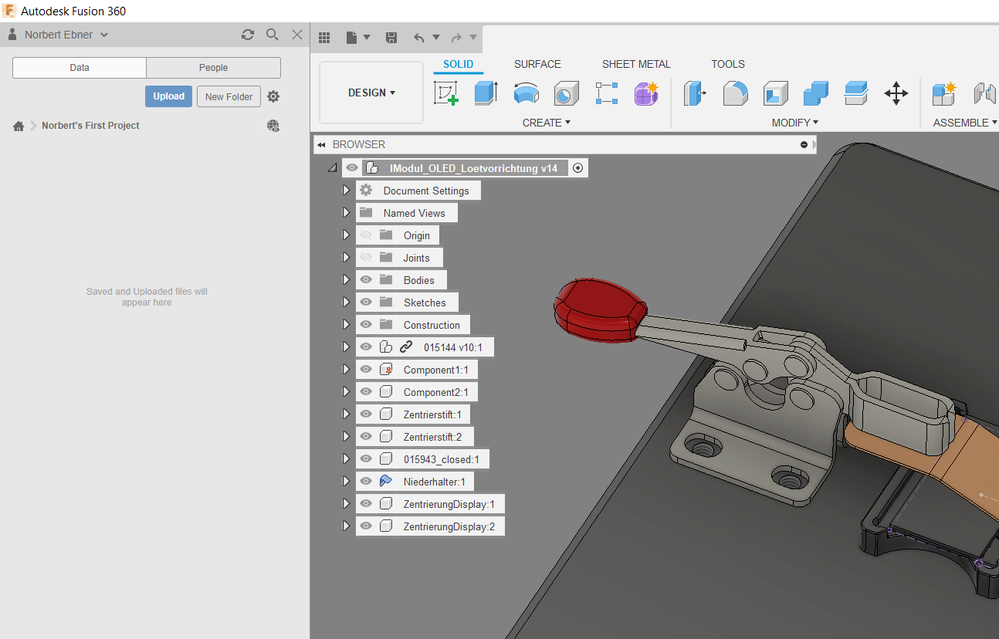

I made 3 screenshots in 100, 125 and 150% scaling. For me it seems that the gui of fusion is doing everything right. Can you confirm that you experience the similar results?
100%:
125%:
150%:

Hi, Just in case if anyone is getting the same blurring issue. I'm using my desktop with 150% scaling (which is default for my DELL INSPIRION 1300 series).  I've got the issue fixed by clicking right button on the program icon -> Properties -> Compatibility  -> Change high DPI settings -> Override high DPI scaling behavior. I've selected 'Application' from the dropdown. Restarted the app and everything shows not blurred anymore, but icons inside the app are quite small. So that is up to you if you would like to use it this way.
