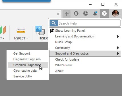

This is probably a graphics issue.  Go to the "?" mark in the upper right hand corner of Fusion 360 and click on Support and Diagnostics and choose the Graphic Diagnostic to check your graphic card driver.  There is an icon at the lower part of this dialog box to check for driver updates.

pat2030303
in reply to: jhackney1972
Changing it to Direct 11 worked.. I have been trying to figure that out for a while now
