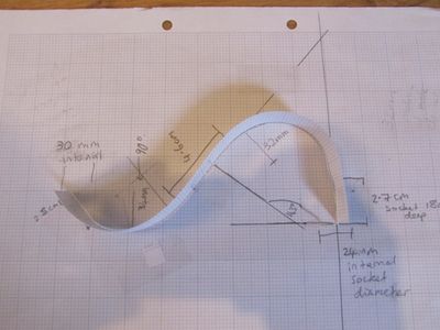

I am home schooling my teen son and he has learned a lot about using Autodesk Fusion from watching videos online.
We would like to try to build a new neck for a bass clarinet and I think it might be a bit complicated. I wondered if I could open a thread here to document our progress and to ask if anyone would be able to give us a few nudges in the right direction if we get stuck?
What we need to make is a pipe that is bent like a curved Z shape. The length must be exactly correct. The internal diameter of the pipe must also be exactly correct and exactly the same the whole way along. Then it needs a socket at one end. But that's all. There are no other constraints really.
The current neck on our bass clarinet looks like this:
https://www.ebay.com.my/itm/145067777085
We would like to make one that is still just a simple tube, but with a steeper angle at one end, like this:
https://www.earspasm.com/products/custom-gold-plated-blashaus-bass-clarinet-neck
The bass clarinet that we have is an old one that is no longer made or sold. Nobody makes a better neck for it like this, so it would be doing a lot of people a favour if we could work out how to print one, and make the file available online. It might take a bit of work though.
I wondered if it would be okay if I tell you about our efforts, in case anybody could help us if we get stuck?
Thanks!

TrippyLighting
there are many ways to approach this. What I am showing in the video isn't how to create the general shape. In reality, you would take precise measurements (caliper, etc) and model accordingly.
Then print, test fit, adjust, and print again to fit.
Also, this isn't the only way to model this.
Hopefully, my EE mates here can show other ways, so you have some options.

jendeegan
Thank you very much for replying. We have made some progress.
The path through the tube is 23.5mm long and we haven't quite got the design to be the same but we will do a bit more work on it tomorrow.

jendeegan
We managed to make the file but now we can't save it. I wondered if you might know what we need to do to save it?

jendeegan
Thank you for offering. My son has plans himself.
Message 11 of 12
jendeegan
First go complete. Makes a hilarious squeaking noise when we play it because it is not air-tight. Even sealing up every crack with duck tape didn't solve the problem. Looks lovely though. 🙂

TheCADWhisperer
@jendeegan
I use drywall compound to cover the entire print, dries fairly quickly and sands smooth.
Then spray paint.
Not sure how well that will hold up under light air compression though.
