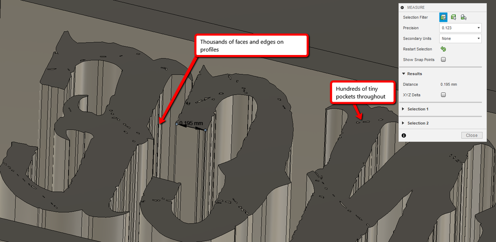

Phil.E
Thanks.
The problems are related to the font. It has rough jagged edges and hundreds of tiny pockets. These are creating vast amounts of geometry data. This is what is making the CPU active.
In just the "stamp" portion, where the art and fonts are used, a quick count shows:
Faces counted 5384
Edges counted 10680
Most fonts do not create so much extra geometry. Fusion keeps close track of all of that for things like CAM or SIM. It also affects graphics display, and selection logic when the mouse is on those (highly populated) surfaces.
Can you tell me what font you used? And what OS you are using too please. Perhaps there is a better way to handle fonts like this and provide a better experience for you.
Thanks for sharing the model.
