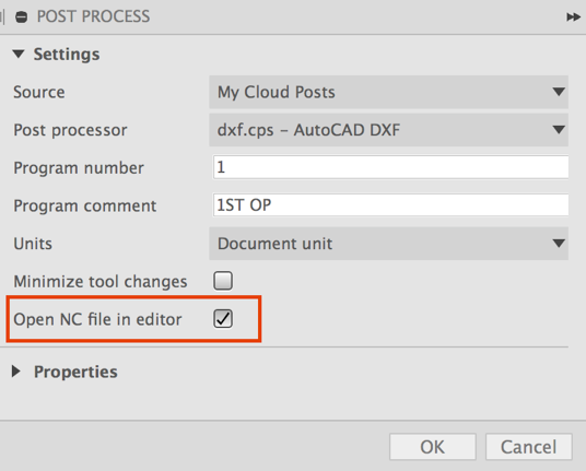

I made a modification to some CAM and rewrote the gcode file. ON examination of the file I found it unchanged from the previous version.  I realized that the file was open in Mach3 and could not be overwritten until closed. Fusion did not produce an error - failing silently.

Thanks for posting! While I do not have access to the Mach3 software, I found that I was able to trigger an error message in the posted code itself when re-posting a program from Fusion with an identical name and output location as an open g-code file in Microsoft Word - Word must lock the file in a similar way to Mach3. This message, however, will only be immediately visible upon posting from Fusion if you have "Open NC file in editor" flag enabled in the Post Process dialogue:openNCfileinEd.png
 Do you have the "Open NC file in editor" flag enabled?  If so, you should see the "sharing violation" error message below in the code when the NC editing program opens;
Error: Failed to open output file 'C:\Users\claussp\Desktop\1001.nc' (sharing violation).

While I agree with the fact that it would be nice to see this error message in Fusion (as you would not see the error message at all if "Open NC file in editor" is disabled), the error message is shown in the posted code due to a current limitation of the post engine. The Javascript post processor is where the code file is actually created and written to the desired output folder on your local hard drive. Because this is done in the post, Fusion does not know that the file is in use elsewhere because it is not actually Fusion writing the replacement file - it is the post processor script instead. Because the simple post script cannot pull up a Fusion error message, it shows the error in the code output file.

If Mach3 is locking the file when it is opened there, enabling the "Open NC file in editor" flag should allow you to see this error sooner rather than later, as it will only be shown in the post. Please let me know if you have any questions - I am happy to help!

Thanks for the quick response. I've enabled that flag now.
