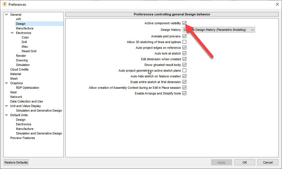

After creating a New Component it turn my previous component to a wire frame.  Does anyone know how to stop Fusion from doing that?

jeff_strater
turn off this preference

jhackney1972
I do not think it is changing into true Wire Frame visual effect, just ghosting correct?  Anyway, try removing the check box in your Preferences.  You may have to restart Fusion 360 to have it take effect.  Try it on a simple assembly first.
