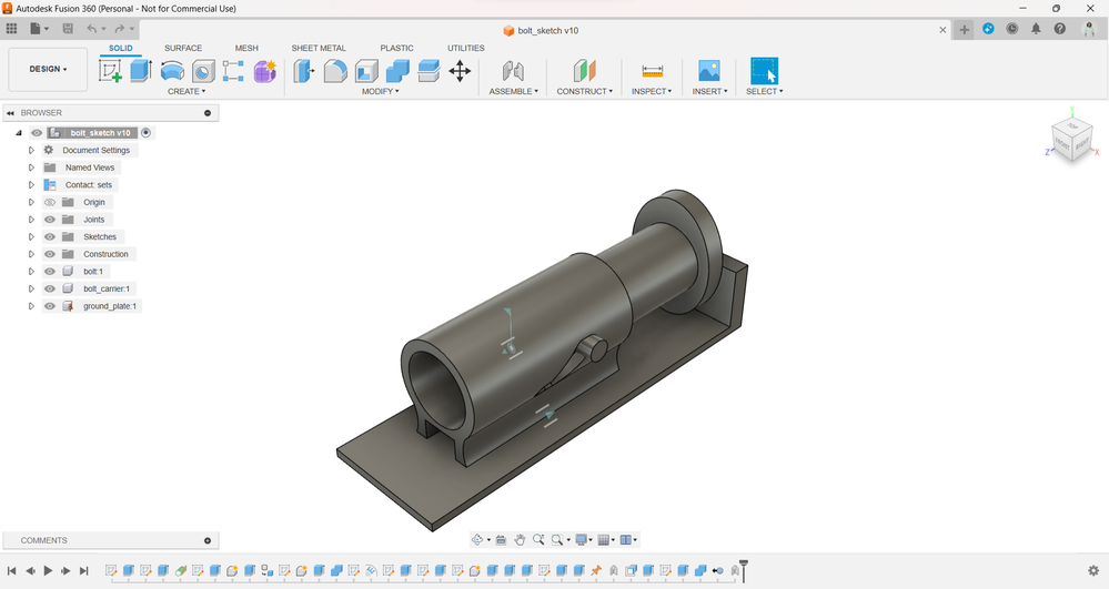

I have created a slot and pin type cam follower mechanism, depicted in the image 1. There are 3 components in the assembly:
  1. A ground plane
  2. A bolt carrier
  3. A bolt inside the bolt carrier
I have created a slider as-built joint between the bolt-carrier and the ground plane and a cylindrical as-built joint between the bolt-carrier and the bolt. I have enabled contact sets and added the 3 components to the set.
On the side of the bolt there is a pin (part of the bolt) and on the same side of the bolt-carrier there is an angled slot.
Now according to my expectations, when I move the bolt-carrier forward, after hitting the ground-plane's perpendicular extrusion, the bolt should rotate clockwise because the the pin following the slotted-cam. But that is NOT happening. Moving the bolt-carrier backwards the bolt-carrier and bolt move back as expected but only when I move them forward and hit the upward extruded ground plane, the bolts stop.
Why is the bolt not rotating as per the slotted-cam and pin mechanism is my question.

@akshaykumark
Did you create your cam slot correctly? (Almost always done incorrectly by beginners.)
Edit:  I see it now.
The cam slot is not modeled correctly.
In addition - several of your sketches are not fully defined?

TheCADWhisperer
There are quite a few errors.
Are you willing to start over from scratch?
Message 10 of 21
akshaykumark
I used the emboss tool to create the slot, initially I kept the width and the diameter of the pin same, 5mm, but now I have made the pin smaller.
Sir what is the Design Intent that I'd be looking for?

No sir they were not fully defined. I did not think they were important. I see may be they are important now. I learnt how to make a slot on a cylinder from YouTube.

Animation of the motion of a pin in a cam slot in Fusion 360 is an interesting feat.  I believe the only animation you will get is to drag the plunger manually.   Attached in my simple mock-up of a mechanism like the one you have .  I created my own dimensions as I could not fully decipher yours.  Please review the method of creating the cam slot in the barrel.  Model is attached.

The "Barrel" I refer to is the cylindrical outside component with the helical slot in it.  I point to it in the attached screen capture.  You can move either the inside plunger, with the pin, or the outside barrel, with the slot depending on your Joint configuration.  I do think however, all motion will have to be manually driven.

That is what I thought - that video does not create the correct geometry.
Very few people in any CAD software know how to model the geometry correctly.
Follow @jhackney1972 instructions.
Here is alternative technique but @jhackney1972 technique is a bit easier...
The created incorrect geometry for a proper cam slot!
