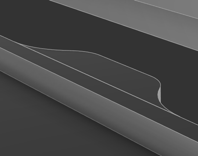

I CNC machine my parts.  From the last few updates fusion is not getting rid of lines after i have joined the bodies together.  I have attached a screenshot and the file.  The part is at the same plane and joined together yet i can still see the line .  This is particular irritating when CNC as i select edges for chamfer ect.  It get confused and doesn't allow me to chamfer just what i want.  Anyone have an idea whats going on?  Thanks

If I am looking at the correct side, your two surfaces are not planar.  The Video will explain.  Model attached.

If this were modeled properly, there would probably be fewer than 1/4 of the timeline items in the timeline, and you would not have these problems.

The issues that you observed have nothing to do with the Fusion release.
Would you like step-by-step instructions on how to model this correctly?
