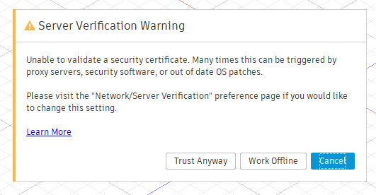

I've been suffering the below (see screenshot) for months now (years maybe even).
Does anyone know what CA bundle fusion is using (what file, or, what store it uses?)
trusting failures is obviously a very poor security decision, so I want to fix it.  I find this in my logs:-
20240403T201644 E 9776 GET 60 https://js.prd.fusionapi.autodesk.com/fusion360-runtime-config/config.json dt=0.53 schannel: CertGetCertificateChain trust error CERT_TRUST_IS_UNTRUSTED_ROOT
20240403T201744 E 9776 GET 60 https://js.prd.fusionapi.autodesk.com/hds/fusion360.json dt=0.66 schannel: CertGetCertificateChain trust error CERT_TRUST_IS_UNTRUSTED_ROOT

... so it looks like every ca-store I can think of of my box is just-fine.
I've erased and reinstalled all my windows certificates
my machine is up-to-date (with correct time etc)
I do not use proxies, and I've tried with my A/V turned off (yes "CERT_TRUST_IS_UNTRUSTED_ROOT" has nothing to do with those things, but I tried them anyhow)
I've tried everything in the help page https://www.autodesk.com/support/technical/article/caas/sfdcarticles/sfdcarticles/Server-Verificatio...
I've uninstalled and reinstalled Fusion
I've done the service-tool repair
Anyone got any ideas?
I do notice, when doing a "dir /s /a *.crt",  "dir /s /a *.pem" in the AutoDesk program root folder that there's a bunch of ca-cert related files that have dates of 2017 and 2020 respectively... and keeping in mind that I just now did a fresh re-install, it does beg the question why antique bundles are shipping in the current product.  (and yes - I also tried overwriting all of them with the latest working ones, which didn't fix anything)
I'm using Windows 1 Pro Version 10.0.22631 Build 22631

After today's huge Microsoft Windows patch update, this issue is now occurring on my other machine (Windows 10) as well...
