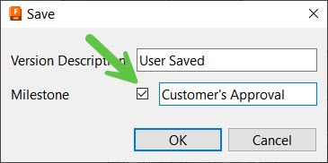

What does the flag next to the name of a project mean?
Luis.lemaEFAMD
What does the flag shown in the attached image mean?
For some reason I can't open this model on the online viewer and I have a feeling it is related to this.

Reply (1)
jhackney1972
The Flag icon  indicates that the file version has been saved and designated as a Milestone during the save.  This version is locked and cannot be updated with a Save.  It should have nothing to do with the ability to open the file.
