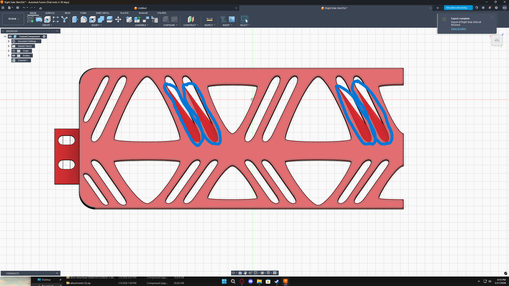

I have never used Fusion 360 before, so please excuse my ignorance 🙂 I'm exporting from TinkerCAD to Fusion 360 to use the chamfer tool to add a chamfer to the top edges; however, when I add a chamfer, no matter the amount, it will add a weird section that's not supposed to be there (highlighted in blue). What's strange is that it only does it consistently on these specific ones. Does anyone know how I can fix this? Thanks!Screenshot 2026-01-17 184327.pngScreenshot 2026-01-17 184409.png

that looks like a graphics artifact.  Try setting the display detail control:
And choose "Fixed", and try different settings.  Usually one will get rid of the problem.
