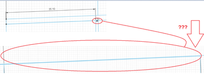

I have a weird glitch that I cannot solve.
First, when I am creating a hole in my part, it creates a tiny glitch, which can be seen here:Screenshot 2022-12-13 115607.png
But this isn't even the bigger problem. Or it solves itself when I do the next step.
The next step is doing a circular pattern to get more holes. When I do this, this glitch appears:
I have already tried a lot of different things, but nothing helps.
The .f3d file can be found down below. I would really appreciate the help.

these are graphics glitches.  Your design itself is fine.  You can fix this using Display Detail Control, as in the screencast:  https://knowledge.autodesk.com/community/screencast/d65038c1-50e8-4ca9-b839-63acd738316e

This instantly worked. Thanks!
