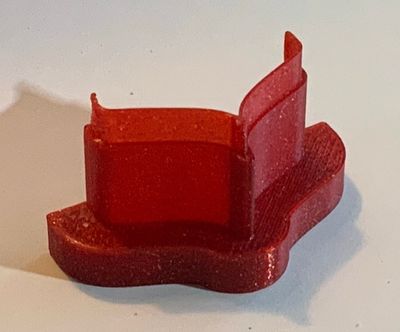

Hi community,
Would appreciate your help, please!
I'm an home baker who uses Fusion360 to design my own cookie cutters for custom shaped cookies. I use PLA as my material. For the past few years, I have not had any issues designing and printing - took a few months off and I'm trying to print today, but its not printing as per usual.
In Fusion360 and Cura, everything looks fine! But when I send to my Creality-3 Pro, it prints everything but the walls to the item. Can someone explain what I am doing wrong and how to fix it? I've attached photos and the .f3d file. Maximum 3 attachments, cannot post a photo of the actual print results.
Thank you!
Hoping for a saviour as I have an order due in two weeks... =S

homebaker-tdd
Thanks for responding, Jeff!
When I slice in Cura, looks fine as well. When I create in Autodesk Fusion 360, looks fine there!
When it prints on my creality... not quite. I attached the photo of my print.
Could you explain what I am doing wrong or if you know a solution?
Im confused!

g-andresen
I think you need to check your printer settings or the printer.
This is what a test print looks like for me with a 0.6 mm nozzle and 0.2 mm layer height.
Günther

g-andresen
Check the G-code, because there are obviously several layers missing.

homebaker-tdd
You were right, there was an issue with the printer itself. After dissecting the gcode, taking things apart and cleaning, manually testing parts... turns out the screws in the coupling were loose, preventing the extruder/stepper from moving up on the threaded rod, but not down. I wanted to come back to update in case someone else faces this issue, but to also thank you Gunther for your time and for test printing with material. I appreciated your effort in assisting!
