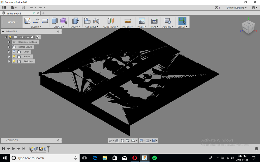

Hi all, I am having some issues with viewing 3d bodies in fusion 360. In some cases the models show, but riddled with black artifacts, other times being completely transparent. The grid background also appears to be missing. I'll post screenshots near the bottom along with my settings and gpu things copied from the graphics diagnostic tool in fusion.
My laptop does meet the minimum requirements for fusion EXCEPT for gpu RAM. My graphics card also only supports dx9. My instructors laptop which is of similar vintage (2007-9 ish) works flawlessly with fusion, and he has 256 mb of gpu RAM, and his graphics card i believe is an ATI mobility radeon 3xxx, I don't recall the exact model but fusion does say that it is using dx11.
My question to the community is are there any workarounds to this issue? It is frustrating that the only thing keeping me from using fusion is the one thing I cannot upgrade on my laptop. If there is no workaround, is there a specific issue causing these problems? (not enough gpu RAM, dx9 instead of a newer version, old drivers, etc.)

No grid when starting fusionNo grid when starting fusionWhat the parts are supposed to look like in the data panelWhat the parts are supposed to look like in the data panelstrange black artifacts in 1st partstrange black artifacts in 1st partappears fine only in sketchappears fine only in sketch2nd part completely transparent2nd part completely transparentProof 2nd part does exist, face highlights when pointer is hovered overtopProof 2nd part does exist, face highlights when pointer is hovered overtop1st part behaving strangely when simulating1st part behaving strangely when simulating1st part simulation works normally with stock turned on1st part simulation works normally with stock turned on

Hi @Anonymous
Thanks for posting! I would start troubleshooting by updating your graphics drivers - yours are from 2007. I usually update my drivers twice a year to keep Fusion running smoothly.
I hope this helps! Please let me know if you continue to see problems.
