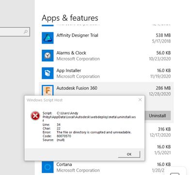

Andy-StanCraftBoats
I don’t know how to do an update routine but I tried to uninstall and got this error in the screenshot attached. Let me know if you’ve seen this. [Image.jpeg]

jhackney1972
I have not seen that one.  For applications that will not uninstall on Windows operating system computers, you normally need to use the Microsoft Uninstall tool.  I do not know what your operation system is.

Andy-StanCraftBoats
After lots of tries to uninstall in different ways it wouldn't uninstall so we reinstalled it over the existing software. This worked but it caused all preferences, shortcuts and settings to reset. It also caused some files to be moved into different folders... this was really frustrating. Not sure why the database would have been affected but it was. Hopefully this doesn't happen to anyone else, I wasted hours so far fixing things and still not done.
