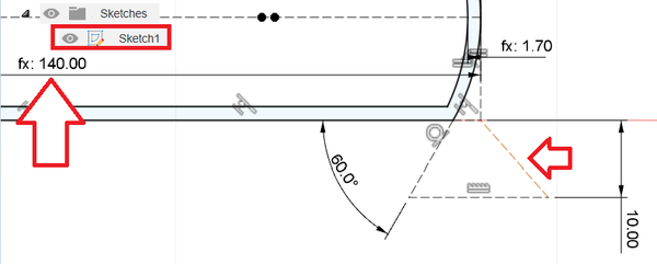

Update: I found the missing constraint and realized I could have even deleted these lines since they are not important to the design. Now, the issue appears as follows:
Message 4 of 10
TheCADWhisperer
@Amyoqzy
Move the 140 dimension up.
You should now see an unconstrained Construction line to the right (in my image I dragged it out of vertical).
Add a Vertical Constraint to this line.
1. Note that it now turns black.
2. Note that there is now a Lock glyph on the sketch in the browser.
The missing Lock glyph was my clue that the sketch was not fully defined.
This line also showed unconstrained in your video and screenshot.
Message 5 of 10
Amyoqzy
@TheCADWhispererThank you very much! I found it a few seconds after replying to your message. Please see the update in my previous reply. As you correctly speculated, the missing constraint does not solve the issue at all.
