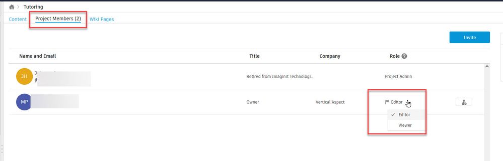

From your brief description, I have guessing your need to edit the Project Members Roles.  In the Fusion 360 Web Database, navigate to the project you want to share and change the role of the Project Members.

You will have to add user rights per project, there is no universal setting that covers all projects because many times people need different project settings.
