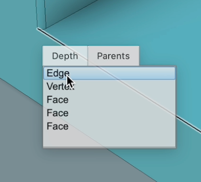

You can also try Select Other (long left mouse button press) to get a list of objects that are "near" the selection point (and also along the view axis through to the back of the model).
 Again, not always true:
60% of the time it works every time.
