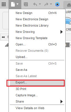

I'm unable to export as stl for 2 files. others are working fine
I already :
restart application / restart PC / clean json file
it's really slow for other files but for this 2 file it's not working.
there is no error message.
I succeed 1 time to export 1 element of the file. But it seem the more I try the less I succeed.
no even the file does not have a picture in the preview when I select it.
I tried to remplace it for a previous version but do not work too.
thank for your help

Hi @al90000,
Can you please provide me more details?
  1. How are you exporting the file as .stl?
    • Through File Export
    • Right click on top browser, Save as Mesh?
  2. Are you able to see any warning when the export fails?

I use export as I need to separate elements
al90000
I just tried via mesh and can see it's working faster than ever.... and I can also separate ....
dsouzasujay
@al90000
Good to know it solved your problem.
Most of them don't know we can use 'Save as Mesh' to save .stl, .obj & .3mf files.
also we can send a file directly to a 3D printer. that's the quickest way to export an .stl.
But can you please share what is the problem you face when you File>Export as .stl?
