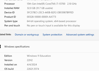

If I open a drawing, I can select objects and delete them, but ALL other functions do NOT work.  Can not get to anything else in fusion, design, preferences, etc.  Have to end task and restart fusion.  Can NOT create a drawing from a new design.  It will not let me place any views, etc.  Stuck on selection crosshairs and that is it. No dimensions, nothing.
New computers,  latest drivers (31.0.21024.3006), latest Fusion.

Hi @philryland
Looks like you have 2 graphics cards, which is most probably the cause of your issue. Take a look at the link in my signature for some pointers on setting up your graphics for Fusion.
