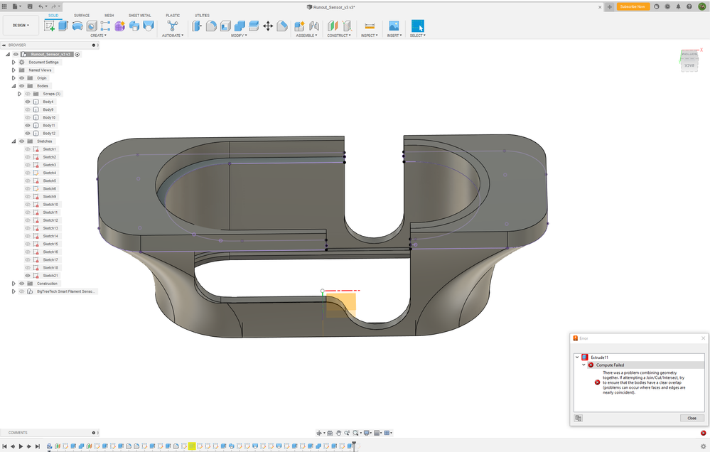

This compute error when trying to extrude and Join is a pain!
badonj002
393 Views
badonj002
Please fix this issue. PLEASE!!!   *.f3d  file attached. Changing board makes all attachments disappear.  Also, drag and drop does not work for attachments.

jeff_strater

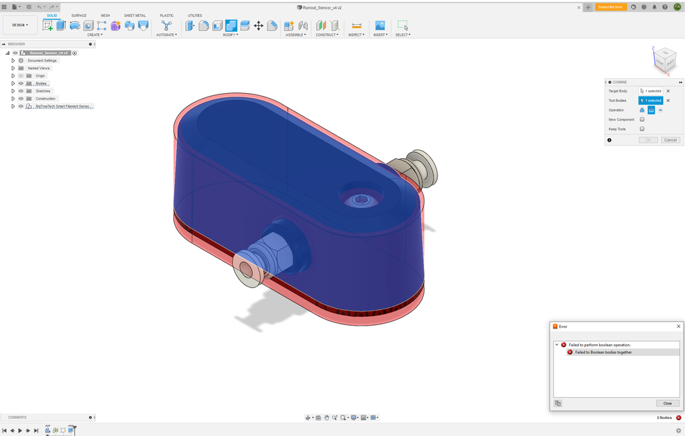

The problem here is that the bodies you are trying to combine have a lot of overlapping geometry.  In the video, I apply red, green, and blue appearances to the bodies, and you can see the "z-fighting", where the red and blue, and red and green are very close, so you get a mix of colors bleeding through.
This is probably not a problem in the planar areas, but on the fillet surfaces, if the geometry that is trying to be combined is almost, but not quite, identical, Combine will fail.  You are welcome to try Solidworks if you'd like, but I suspect you will have the same problem with this type of geometry.  I tried in Onshape, and got similar failures.
screencast:
