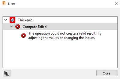

Later on when I am done. I want to thicken the entire model so that I can give a little "wiggle room" for the inside piece (the one I'm trying to thicken) to comfortably slide into the outer piece (the one I will cut using the thickened piece). So I cut off the bottom with patch tools and then used the thicken tool to thicken everything except downwards by 0.2mm. This results in the error...
The error message I get when trying to thicken 0.2mm:
"Error: The operation could not create a valid result.
Try adjusting the values or changing the inputs."
Expanding the error gives me the exact same message.
However, if I increase the thickening to 1mm, then the process will work again. I found that only values under something like 0.99mm will give "valid" results.
(I have also tried simply selecting the solid model, before removing the bottom with the patch tools, and simply "extruding" it thicker, or "push/pull"-ing it thicker, which also failed.)

It's the sketched fillet / radius that causes the shell to fail.  The result of the pinched corner was where I thought it was going to fail....
So redoing the gusset with out it, worked for me, I added the fillet to the lower original shelf, but will be something for you to consider in any redesign....
What I would do, 2 fillets, the internal first, then the left edge, so that the shell still works.
Fillets with the modelling area is recommended in this scenario....

Although that isn't exactly the solution I wanted, it is good to know what is causing the error. It would sure be nice if the thickening algorithm could handle such intersections/curves/etc., But until then I now know how to work around the error.
