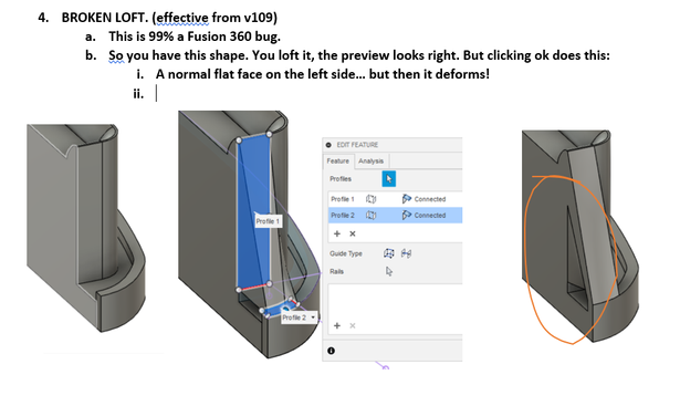

As the following describes, I've found a bug in Fusion 360.
I apply the loft to the following profiles, and so far the preview looks fine.
But when I hit OK, immediately a deformation appears!
I'm sure that this wasn't caused by any other feature, as this results immediately from the loft itself.
Is anyone aware of lofts breaking like this?

In the majority of cases this means that you are trying yo create geometry that is at the technical limit for the loft tool. In the majority of cases that should yield a different modeling approach.
While Autodesk has a tendency to "fix" problems like this and still allow the user to create often absolutely horrendous geometry (it isn't horrendous in this case, but it isn't good either) I would still recommend changing the modeling approach.
You might get past this hurdle with the current modeling  approach, but often once bad geometry is created problems start compounding and so does frustration!
Let me see take a look at the model and provide feedback ...

So here is one better workflow:
I rolled the timeline back to before the loft in questions and unhid sketch "Front/Rear Supp Sketch"
I then use a line in that sketch with the "Split Face" command/feature to split the two selected faces:
 I end up with this split line highlighted in red:
Then I extrude the lower of the 2 faces "To Object" to the upper surface:
and end up with this:
This provides 2 faces for a simple solid loft.:
With no holes on the other side:

@maula006 - yes, this is a bug.  I created bug FUS-96623 for this.  As @TrippyLighting says, though, this is not a recommended modeling technique.  I would never recommend using a loft where one of the profiles is essentially co-planar with one of the lofted faces:
So, I would recommend some of the techniques discussed here instead.
However...  If you really do want to use the profiles as you have them, the usual way to avoid these kinds of "point mapping" errors is to create rail curves.  Create another sketch, Include the points from the two profiles, and create a 3D line between them.  Use that line as a rail curve:
