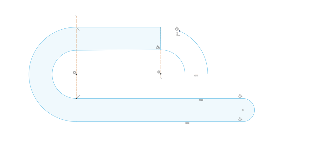

Hello Fusion forum,
Sketch is extruded and finishing piece with filet.
Get error message: "The filet chamfer could not be created at the requested size. Try adjusting the size, deselecting some of the edges. (Try disabling Target Chain), or using, multiple operations.

    The sketch was redrawn and as new parts of the sketch added the part was extruded and fileted successfully.
    but when the last section of the part is added as defined by Curve Alpha, as shown in the image below,
    the error reappears.
    Also tried Create Mesh Section Sketch.
    Was unable to create the sketch or do anything beyond the dialogue box shown above.
    How can the filet be completed?

KristianLaholm
Your first sketch is broken, one of the arcs are not correctly attached to the lines (there are some more strange lines floating around in the sketch).
In the image I have dragged the arc end point away from the line.
Fully defined sketches can help you avoid problems like this.

jeff_strater
@KristianLaholm has it right - there is something wrong with that sketch.  Fillet is very sensitive to tangency.  If I redraw the sketch focusing on tangent constraints, the result can be filleted.  Also:  It is better to go back and edit the first extrude rather than extrude, apply one fillet, extrude again, and apply more fillets.  You end up with fewer features (you really only need 3 here - one sketch, one extrude, and one fillet - i made the fillet in two features, but that is not necessary)

pittsallen
Hello @KristianLaholm@jeff_strater@TrippyLighting@g-andresen,
The excellent advice and counsel is much appreciated.
The sketch was redrawn with special attention to tangencies.
It seems that keeping the sketch as simple as possible is important.
