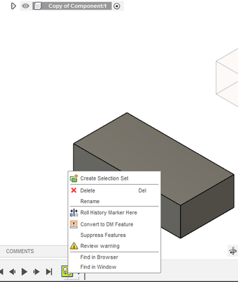

Hello everyone
If I create a new component with boundary fill, I can edit this feature in the timeline at any time.
If I create a new component with CopyPaste, I can't edit this feature in the timeline and thus all subsequent features are lost.

This is a known limitation and doesn't look like it'll ever get fixed! The workaround using boundary fill is what I've used and recommended on the forum for years.

Yes, it's a shame AutoDesk don't think this is worth fixing. As well as the problem of fixing a lost reference it also gives you the option to change the reference to a different body if you need to.
One excuse is that there is no UI for this, you don't get a dialog when creating a copy. But you don't get a dialog when you use Create Components from bodies either but you can edit a create components.
This is a create components feature and you can edit! The help text looks totally wrong though!
