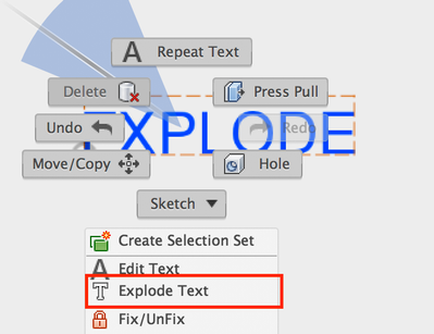

As a workaround, Have you tried to use "Explode"?
After creating the text and then click the right click, you can see the explode option.

I have tried to explode it and nothing worked I ended up using another font that in fact did work I am on the app in my pine and can possibly share me design tonight on my computer

1. For some fonts, overlaps prevent conversion to curves (explode).
2. Fusion prefers OTF fonts.
3. If you still have problems, create the text e.g. in Inkscape and import it as SVG into Fusion.
