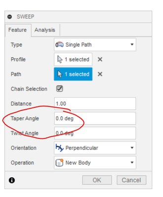

I was trying to use the sweep command, and noticed that is missing the taper angled option. Did they remove it in the last update? see attached picture
Does anyone have an alternative method.

What happens if you set Perpendicular rather than Parallel?
Is your Profile perpendicular to your Path?
Do you want a "squashed" result?
More information is needed.
Can you include image of an existing real world design that is similar to your design?
HughesTooling
It's because you have the orientation set to parallel, you need it set to perpendicular.
Edit. I see @TheCADWhisperer  already hinted at that.
Even with a line and circle that are perpendicular it will not give the tapered option if set to parallel!
