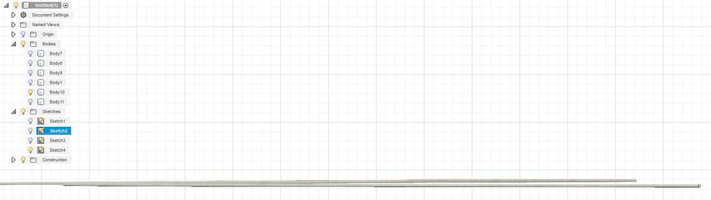

I made sweep operation and gave 360* as twist angle . BUT the operation is not happening
please help me. thanks in advance
i made sweep operationi made sweep operation

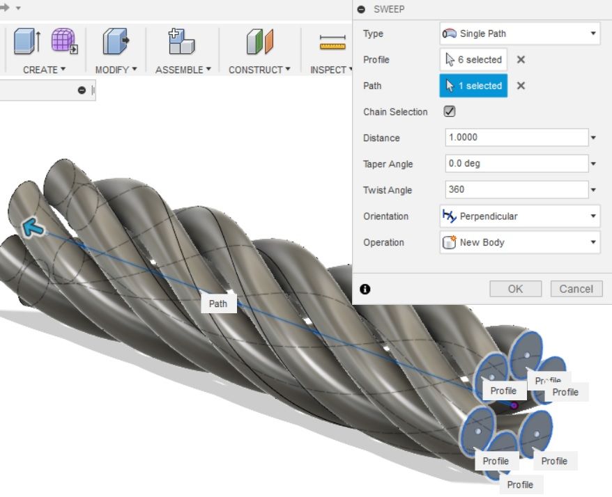

thanks for posting. I tested the sweep feature on a similar geometry and managed to get this result:
Sweep 360 degreesSweep 360 degrees
Could you share a link to your design with us to test it further?

thanks for sending over the design! I believe the operation actually is happening, but the effects are difficult to spot due to the length of the path. Here is a screenshot of a body created from just one of the five circles - it does twist 360 degrees along the chosen path.
Sweep Twist AngleSweep Twist Angle
Changing the Twist Angle to 30600 (which corresponds to 85 "twists" along the path) allowed me to achieve this effect:
Sweep Twist Angle 30600Sweep Twist Angle 30600
For higher values the operation seems to fail due to some geometry conflicts.
