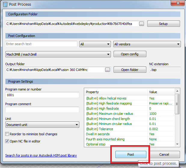

Hi @tfarllc,
Thank you for your response. I confirmed that Fusion does not load the entitlement correctly without internet connection, and I was not able to access advanced CAM feature including Probe, Multi axis, tool orientation, etc. in offline mode. I've reported this issue to the development team and they will investigate the issue further. I apologize for the inconvenience. (the ticket ID is FUS-40035 just for your reference)
However, I'm still having difficulty reproducing the issue with posting G code in offline mode. What happens if you click Post button? Do you get the error message about license?
Could you describe the steps that cause the issue in more details? Also, some screenshots would be helpful as well.
