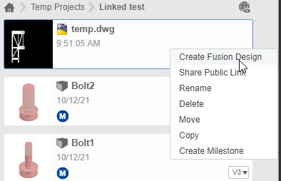

HI,
I have received some new .DWG files from a supplier and the online viewer will allow me to navigate them in the 3D view is there anyway of making these compatible with Fusion360 ? currently it allows me to upload them but will not give me any option to insert or use these files on the desktop it only opens the online navigation panel?
thanks any help appreciated. i have attached a file for reference.

How are you importing the file. I used Open from the file menu and it imported fine. You'll need to either use Upload or open to translate the file.

If you uploaded through your Hub you'll need to right click the file in Fusion's data panel and use Create Fusion Design to translate the design.

Conversion in the cloud is not possible with a personal licence.
