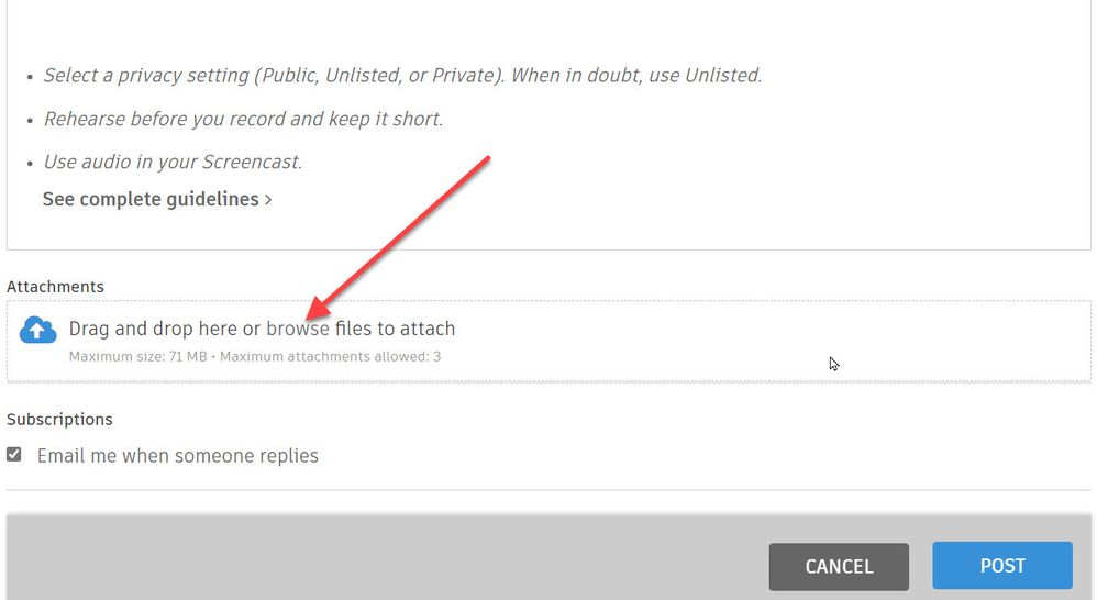

jhackney1972
The file must be attached using the Attachments section below.  If you use this and still have issues, zip it up first.

Message 5 of 9
I used this section but i had the error msg. So here is the zip file.
