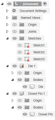

At least show screenshot image of expanded browser (especially the Bodies nodes).
Something like this
To take a screenshot:
Shift Win S and Ctrl v into a Reply here if using Windows OS.
I assume there is a similar procedure for Mac OS.
(Or use your cell phone camera.)

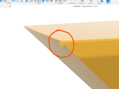

Thank you Jeff.  I went back to a primitive state where the problem still persists and I can share the project file.  I have  also discovered something interesting along the way:
1) The "bottom" body won't export at all, just comes out blank.
2) The "top" body exports, but it doesn't export properly.
It is supposed to look like this:
 But instead it comes out like this:
I've done numerous iterations of this part, using the same sketch files, and this hasn't happened before.  Is there a chance my project file has become corrupted?  If so, is there a way to repair it?

Thanks for sharing the reduced model, @glencandle.  Yes, there is definitely a problem here.  However, my results are slightly different on a round-trip export (export to STEP, re-import).  Both halves come back in, but they are surface bodies, not solid bodies as in the original:
second, as you noticed, the geometry around the blends at the corner are not right:
Finally, if I roll back before the Split Body Feature, the round-trip is fine.  So that split must have introduced some challenging geometry:
I will bring this to the attention of the translation team.  The results for IGES export are the same.  I did not test other formats.

Thanks Jeff, I appreciate you looking into it.  The only solution I've found is shrinking the size of the Fillet.
Life's a compromise I guess, lol.
