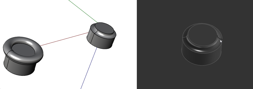

This problem is as much down to Rhino as Fusion, the STP file in your first post opens fine in ZW3d and Geomagic. The reason you are getting blocks is because Rhino is not trimming the surfaces correctly so it's converting it to a block. I've seen this a lot with imports from Solidworks where a trim doesn't work and for some reason rhino then converts the collection of surfaces to a block.
I've also seen a lot of problems exchanging revolved fillets and tori between CAD programs so can you construct the part in a different way?
For example I tried using Split Face on a surface from a trimmed torus and it imports correctly.
Here is the before and after in Rhino and the split surface in Fusion. Also you should report this on the Rhino forum so they can tune up their importer.

I can confirm something has changed. Here the part on the left was exported a couple of months ago and is clean, the part on the right is what I get now and the fillets are coming in as tori! @innovatenate I don't has the STP file any more from the clean version but something has definitely changed.

I just received an update from our development team. After some investigating, they have determined that the issue is not in the Autodesk translators. There is a Rhino import bug/weakness exposed in Rhino 5, but the good news is its slated to be fixed in 6.
I was informed that some preliminary testing in a Rhino 6 beta (codename Serengeti) showed improvements.
