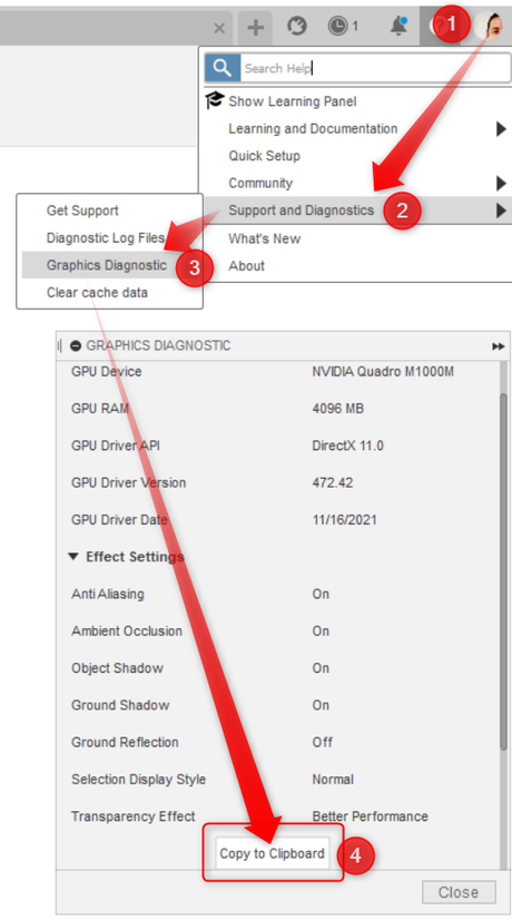

Hi @Swarfmaker
Please can you send the links to both of those drawings, so that the team can investigate.
If it is sensitive, feel free to send it directly to me Clint. Brown {a} Autodesk.com

ClintBrown3D
Hi @Swarfmaker
@g-andresen makes a good point. Please can you also share your graphics diagnostic with me.

ClintBrown3D
Hi @Swarfmaker
Please can you share your graphics setup with us, as laid out above?

[GPU Information]
GPU Device: NVIDIA Quadro RTX 4000
GPU RAM: 8064 MB
GPU Driver API: DirectX 11.0
GPU Driver Version: 472.39
GPU Driver Date: 10/23/2021
[Graphics Effects Settings]
Anti Aliasing: Off
Ambient Occlusion: On
Object Shadow: Off
Ground Shadow: Off
Ground Reflection: Off
Selection Display Style: Simple
Transparency Effect: Better Performance
[Limit effects to optimize performance]
Off
