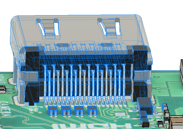

It is also extremely detailed. Just a sample: This connector alone has about 4 thousand edges.
There are 779 objects 1mm or smaller on the board. Mostly these are surface mount solder joints like you see here.
One suggestion would be to reduce the complexity of this circuit board assembly. Unless you need it for rendering, those thousands of tiny details are only hurting the performance.
