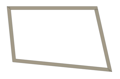

I'm having issues with sketches losing the geometry they are based on/projected from whenever I update the parameters. This is a consistent issue I've been dealing with in several different situations. I've been using workarounds for a lot of them, but I'm not sure what to do here. I want to break the original part into four pieces with dovetails to join them.
Everything's working here
Here I changed the parameters to AB:80, A1:40, A2:85, B1:85, B2:40 - and now the dovetails have lost their position.
An explanation of what's going on or suggestions what I can do would be appreciated, thanks!

jeff_strater
I think that, before we look at projection (I actually don't believe the projections are wrong, but that is for later), we need to just look at Frame Sketch:
There is a whole bunch of missing constraints here, that, I think, lead to bad behavior.  From the start the left side is not even vertical (which I suspect you want it to be).  I think that leads to this sketch behaving very badly on parameter changes.  If I just do step 1 (AB to 80), I get an error.  Step 2 (A1 to 40) results in this:
At that point, you should stop and not try to go farther, until this base sketch is better behaved.
This geometry is very simple - just two rectangles.  A couple of suggestions:
  1. Use the standard two-point rectangle - it will have all the necessary constraints.  If you dimension it, it will be fully constrained
  2. I would not use offset for something so simple.  Just add a second rectangle, and dimension the distance.  To be honest, that is because I know offset, even with simple geometry, sometimes has problems.  That is not ideal, I know, but, if your interest is getting this to work, I would stay away from offset.
  3. that, by itself, should fix this base sketch
  4. the rest of your design should be much better behaved now

OK, thanks.  But, a lot of what I said still stands:  You should first get your base sketch worked out.  Create your base sketch and your user parameters, and then exercise the heck out of it, making sure that it behaves as you expect before proceeding.  In this case, that does not happen.  So, that should still be your first step.  In your simple example, I would not use those diagonal dimensions to control the shape, I would probably use angle dimensions, but that is preference.  The key is testing your sketch.  If it behaves as you want, then great.
Regarding offset:  I understand that offset is sometimes useful, even necessary.  I just tend to avoid it myself, whenever I can, because I know that downstream references to the offset geometry can be fragile.  See:  not-sure-why-this-explodes-so-much .  So, I avoid it when I can.  Sometimes Thin Extrude can work around this - just draw one set of curves, and use Thin Extrude to generate a thickened version of that set of curves.  Sometimes it is easier to draw a second set of geometry.  You have to consider the whole cost here.  Yes, the initial creation might take longer, but if you spend more time later fixing things, is that initial shortcut worth it?
Regarding broken projections.  I do not see any broken projections in the sample model.  I may have done something differently, but the projections here are solid in my testing.  It really helps if your projections come from a face, and not edge-by-edge.  Edges are more fragile.  If you just sketch on the top face of Extrude1, I expect the projections will never fail.  Now, what I do see is that the additional lines for the dovetails come loose.  I suspect that will be better if you fix your initial sketch behavior.  The reaction of that first sketch to the parameter changes was so severe, and involved errors along the way, that I suspect that there is some correlation to those error states.

Yep I can repeat this here, OP file and even with new file.  At first I figured there was not enough geometry to fully constrain, so I rebuild the cut profile (with more geometry) and changing the frame left them behind.
@jeff.strater or @Phil.E
Presume the Op did as I did, copy paste then constrain the profile.  Had the sketch fully constrained, and changed the frame layout, the profiles did not follow the update.  New sketch lines not copy pasted, did update correctly.  But sketch failed with coincident constraint errors after pasting.  Forgot to save my file.
Jeff, After reading your submissions, I was projecting corner points, not the whole frame or face, and 2 edges for the bottom left cut alignment, joining the corner points did not fail, but attaching a copy pasted profile, unhooked the lot.
I presumed only top item to be horizontal, and let the rest go where it has to.

Message 12 of 21
davebYYPCU
I have updated the file, can't break it with my testing.
I did not
Copy paste the profile for the dovetail.
I did not use Sketch Offset in those Profiles.
I did
Project only necessary points and lines to get the job done in sketch 2.
Draw and constrain each profile.
Used Thin Extrude to cut the profile as required, tolerances to the OP.
Profile extended past the projected points for very acute angles, accommodated.
Profile has 1 symmetry constraint set.
Might help....

@davebYYPCU thanks for the help. Here's a video of me breaking your model. I'm just updating the parameters, which is what I do with the model. I'm nesting the frame pieces and sending a CAM file to our CNC machines. I'm doing all of this with Fusion 360.
I was using the colinear constraints to compensate for the changes in angle with the offset I was using on the dovetail. You showed me a better way of creating the dovetail and in my most recent model I removed the colinear constraints. Now even without these constraints my model is still breaking. Here's the video of this again, as you can see no constraints are being broken, but the sketch is not following the projection.
This looks like a bug to me, unless there's something I'm still missing. I've attached the model used in the second video.

davebYYPCU
Oops, I must have attached the wrong version,
I know I had a version where the crossing diagonals were on the Origin.
No matter, after watching the videos. There are known bugs for large incremental parameter changes, and sometimes also involve Projections, I have restructured the file, and again so far, I can't break this one.
In this version I added the construction miter lines to sketch 1.  Only projected those, and built the dovetail cut on those projections.  Used more Equals Constraint, and less dimensioning.
