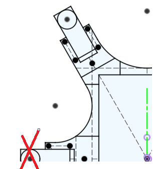

Here's the sketch. There's also the line I am trying to delete.
Thank you in advance for the help.

@up201806660 wrote:
I am trying to learn but I am still a beginner.
@up201806660
Did you create this sketch or did someone else create the sketch.
The sketch is far more complicated than necessary.
Are you following instructions from some tutorial?
Would you like to learn how to do this correctly (warning - will require starting over from scratch and following my steps precisely)?

First I split the sketch into multiple sub-sketches that made sense. But one person on discord told me to do like this. The problem I was having was about the parameters not going well with projections. Also situations where there are 2 solutions for the constrains.
Yes, I am willing to start over. It would just be like the 5th time xd. I really want to learn CAD

You are doing well for a beginner by using symmetry about the Origin and fully defining your sketches, but -
Don't duplicate sketch geometry (except in rare cases).
I see six duplications of the servos - don't do this.
The Servo is one component (sku number) ordered @ 6 instances from vendor.
The way you are modeling it is computationally equivalent to redesigning the same thing 6 times.  Design once!
Now you might have limited duplication for the purpose of visualizing the overall "big-picture" layout, but keep duplication to a minimum.
Start a new file.
Sketch only 1/4 and omit duplication of servo.
Attach the new file here with ONLY this 1/4 completed.
Here is example of my start...
I will not create anything outside of the upper left quadrant other than my initial construction rectangle. (unless there is some non-symmetrical geometry)
