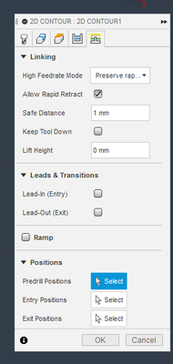

Until today we always created toolpaths for our 5mm mill, making 5.2mm holes. This always worked fine but since today this no longer works. I’m on version Fusion360 2.0.15022, my colleague is still on version 2.0.14xxx and he does not have this issue.
In my screenshot you can see I have selected holes which are 5.2mm in diameter and I want to mill these using a 5mm mill. I did some tests to see which holes it accepts, and it only starts creating a toolpath for holes of 6mm diameter.
Any idea what recently changed causing this issue?

You did not supply your model so made a quick one with 5.2mm holes and a 5.0mm end mill, I had no issues with Fusion 360 Version 2.0.15022 (latest)  Model is attached.

@jhackney1972  You've turned off all leads and ramp, would be interesting to see what @t.velraeds has used on the linking tab. I have heard reports of defaults being reset occasionally by updates so that might be the problem.

Thanks for the replies and sorry for my late reply. Yesterday we contacted autodesk support and after some teamviewing they managed to reproduce the issue and are you the discuss it with development.
For now they gave us two workarrounds:
1. Using the bore option as already mentioned in there
2. Setting an entry point on one of the holes, this also allows the toolpath to be created.
