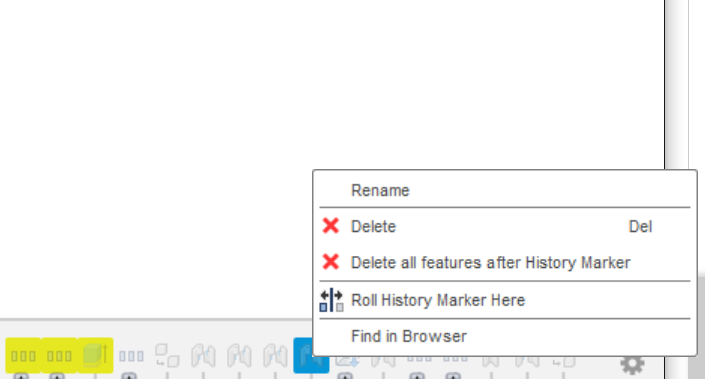

josh.sapp
Guy
I don't know if your history marker disappearing is the same as I have been seeing, but I have had similar troubles. when it disappears I can still maneuver where it should be by right clicking on where I want the history marker to roll to. to get the marker to reappear I have to restart fusion. Ignore all the warnings in my time line they will be repaired later.

Phil.E
The timeline marker is known to disappear under very specific conditions. Try to avoid:
1. Opening the data panel: If the timeline marker is off screen when you open the data panel it will not be visible again until you close the data panel.
2. Resizing the application frame. If the timeline marker is off screen when the application frame changes size, such as going from maximized to a smaller size. Maximize Fusion when this happens.
3. Repeatedly pressing "move to end" timeline control. This is the play control that puts the timeline marker at the end, and also changes the view to see the end of the timeline. Try scrolling timeline view back and forth, or pressing the button again.
4. Dragging the marker*. When a sub-component is active, and the end of the timeline is off screen, and you drag the marker towards it, and bump into the right side of the screen.
(*this particular item should be fixed in the October 2020 update, please let us know if you continue to see it)
5. Timeline icon list not updated correctly when returning to a part after swapping between part tabs
  • Timeline view is reset to beginning of timeline, scroll bar is in same position as prior to switching tabs.
  • Remedy: move timeline scroll bar to see the marker, which is there, but it's off screen after switching tabs.
Original post:
https://forums.autodesk.com/t5/fusion-360-design-validate/history-marker-keeps-going-missing-on-me/m...
If you find a way to make it disappear other than these 5 actions, please let me know.
