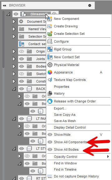

I have drawn a corner kitchen cabinet with component parts and used the hide command to hide some of the components and now I cannot turn them back on.  Is it possible to setup a toggle switch to turn on or off bodies or components?

In your attached assembly, I only found one body within one component turned off.  Next time you think something is turned off and you do not want to look for it, use one or both of the indicated commands.  These are found by right clicking your mouse on the top of the Browser on the Assembly name.
