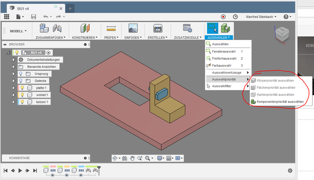

Selection priority options greyed out in german version
Germanselection priority german.PNG -> Body/Face/Edge options not available -> ??

Hello @Anonymous,
thanks a lot for bringing our attention to this issue. I logged it in for investigation with our development team with the following number: FUS-41188. I was able to reproduce the issue for all non-English language versions. The only workaround for now seems to be changing the language to English. I'll keep you updated. Thank you!
