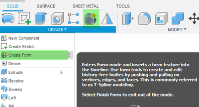

g-andresen
The term Sculpt was replaced by Form

thank you for your help.  however, I don't have "form" either?form & sculp missing.jpg
