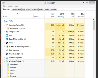

Why is there a 13 in brackets after Fusion's name, normally this means you have 13 instances running. This seems a bit odd, any idea how you've ended up in that state? If you reboot your computer and start Fusion does it still show a number in brackets. I only use Win8.1 so may be different on Win10?

jhackney1972
Mark,
Mark, if I expand the Fusion 360 entry, in my Task Manager, you will see all the sub-applications it is running.  This is the number you see after the entry.  If you are using Windows, open the Task Manager and you will see similar entries.

HughesTooling
@jhackney1972  Must be a Win10 thing, with Win8.1 you only get a number if there are several instances running.
