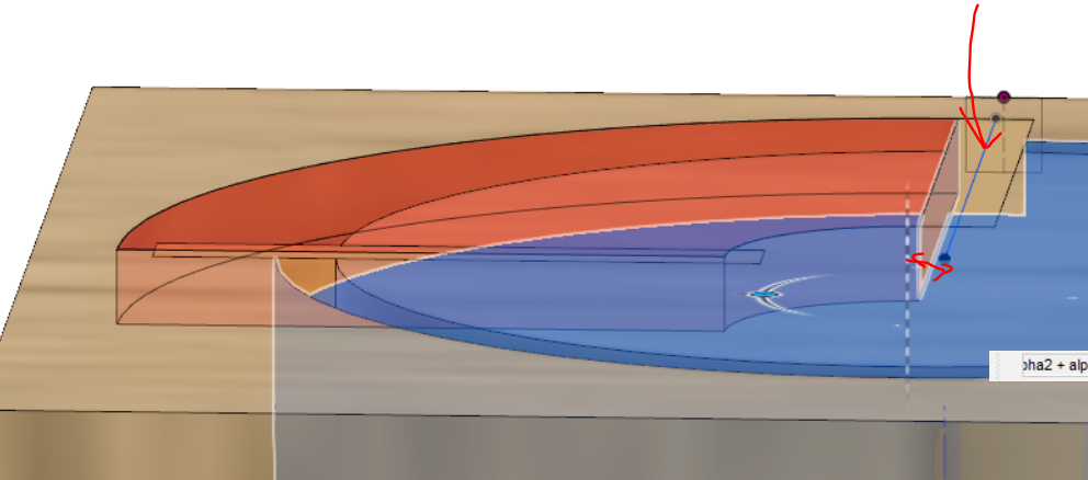

Today I used a feature I've not used before.  It is behaving in a way that surprises me.  In the attached file, I have a center "dial" and an outer "case".  I want a pin in the dial that I can turn 90 degrees.  The pin would slide along a circular groove in the case.  So I modeled the pin, and tried using the revolve feature on one of the pins faces to model the groove.  This mostly works, but as the pictures show, Fusion 360 doesn't use the axis of revolution I selected.  It is as if the axis has been project into the plane containing the face I selected to revolve.
For comparisons, I copied the pin body and rotated the copy 90 degrees to show where the revolved should have landed.  I also have a picture showing a nearly full revolution circle, which demonstrates the location of the axis.  I have tried selecting the origin axis and also the circles on the dial and the case bodies.  Nothing seems to do what I'd expect.

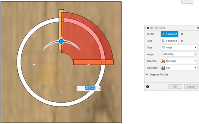

This picture shows a 90 degree revolve of the bottom face of the square pin.  Note that the revolution goes to the center of the target pin location, not the "first" face, which is what you'd get if it used the proper axis.  Also note that the arc doesn't reach the tip of the second pin.
Revolve issue 1.PNGThis is a closer image showing the same thing.  You can see here how the revolution circle/axis is shifted down.  It is as if the axis I selected is projected into the face that I'm revolving.  Is that expected?  It seems surprising to me.  How do I get it to use the actual axis I selected?

You have picked the side of a body that does not go through the axis as your profile.

For those of you simply interested in fixing a problem like this in your project, make sure the plane you sketched the profile on also contains the axis. If you are using the face of a body, sketch a profile of that face in the same plane as the axis (or move the body/reconstruct the face in plane with the axis).
To understand why this happens (and unless there is another use or good reason this approach is taken, why it could be considered a flaw - or bug), here is what is happening and why.
Another way to describe what is happening is that the axis selected is used in two ways, it is a direction and component of displacement measurement:
1. The direction of the axis around which the profile revolves (e.g around the y-direction - not axis!).
2. The perpendicular component of displacement (between profile and selected axis) that has the same plane as the selected profile/face.
What then happens is the axis of rotation is constructed at the component of displacement using the same plane as the profile with the same direction as the selected axis.
