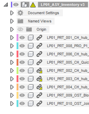

I am working on an assembly with a number of sketches and custom parts. I also have a lot of standard McMaster hardware components. Early on in the design, I created a new sub-assembly component called "hardware" that I was dragging standard components into so the browser tree remained small and tidy. Sometime recently, Fusion stopped letting me drag and drop components into this sub-assembly, and now my tree is a mile long with standard parts. Has anyone else experienced this with large assemblies?
I have tried cutting and pasting into the hardware assembly, but no luck. I can copy and paste, but then I need to re-do all the joints (theres a lot of joints). I have also tried opening a different smaller part file, and checked that I still can drag and drop things into sub-assemblies. I believe my large assembly just is too much for Fusion to compute the drag and drop. Please let me know if you have experienced this and have any work arounds, thanks!
Message 36 of 37
contactPAUJP
I can help you with that. Just press CTRL+B to rebuild the project. It should do the trick 🙂
