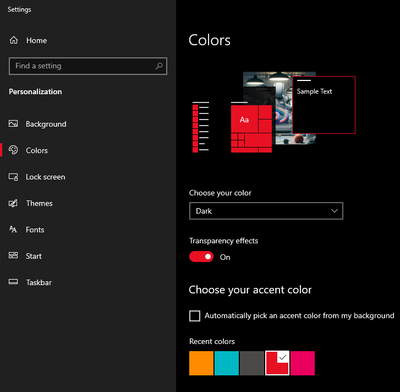

Since the May 2024 upgrade the input boxes in sketch are showing red numerals when before they were always black.  Is Fusion trying to tell me something and if so what or is it just an enhancement that I cant find reported on?  Very difficult to post a screen shot as the command ends the moment I try capturing it so I photographed with my phone.  Hope someone can help  as it is quite annoying having an unexpected change like this.  Cheers

Hello Mark, I have attached a better image I hope of the area I am asking about and have outlined the input box in Blue.  When I am in sketch mode and create a line the input box showing the length of the line is now in red.  It never used to be and was always in black.  It may not maqtter and it is just a change but usually I associate unexpected color changes in Fusion with something needing attention.  I certainly haven't seen any problems or error messages associated with this new look and I haven't deliberately changed the input box color so really just a bit confused.  Hope you can enlighten me.  Cheers

Message 9 of 11
Phil.E
Check your color settings. The accent color is used for fields like this now.

TrippyLighting
Good tip!
My accent color is indeed red.

leslieFRT9A
Thank you for the tip.  After unsuccessfully finding a solution from a very helpful Praise Tom at Autodesk i suddenly twigged to the accent colour as the possible culprit and immediately found the answer. I have no problem with it being any colour i just wasn’t sure Fusion wasn’t trying to tell me something by suddenly making it red-my accent colour!
