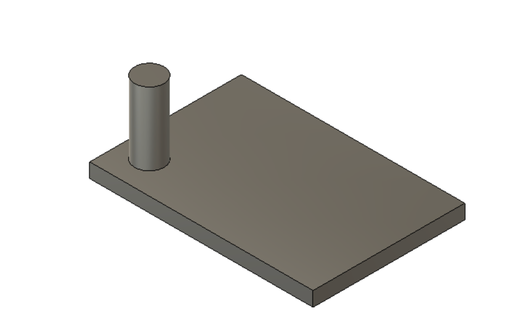

OK, so then, the minimum counts for any pattern should be 1.  It should work correctly.  Here is a model with a box, an extrude of a cylinder, and a 3x3 pattern:
If I edit the counts in this pattern to both be 1, we are left with the original cylinder only:
model is attached.
