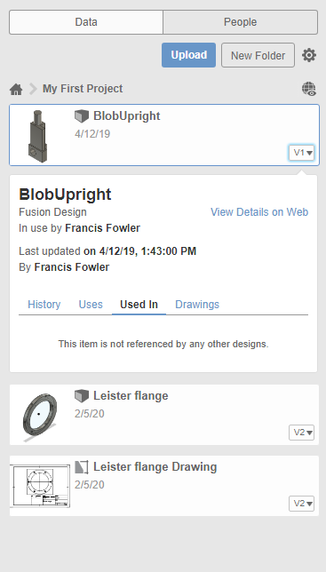

I'm trying to clear out some old files that I made when first learning Fusion360.
When I try and delete file (data panel, right click menu, delete) I get an error saying "This document is in use and cannot be deleted".  I've tried closing and reopening Fusion360, but the error still occurs.
I am not aware of the file being open anywhere else, and Fusion360 claims that the file is not referenced by any other designs and has no drawings made from it.
I have attempted to delete the file using the web interface instead, yet the only files that appear on the web interface are those which I have already deleted and are in my trash.  No non-deleted files are showing for this project.
Fusion360 2.0.8156, Windows 8.1

Hi @jhackney1972, thanks for the reply.
Fusion360 claims there are "No drawings for this design" and "This item is not referenced by any other designs", suggesting the first two rules are not an issue.
I'm not too familiar with versions, but this component is only version one and is not used in any assemblies so I don't think rule three should be an issue either.
Message 4 of 9
OK, so I opened the file and closed it again and then Fusion360 allowed me to delete the file.
I don't see why this ought to be a necessary action for deleting files, and there must be an underlying bug at play, but I wouldn't know how to recreate it.
In summary:
Restarting Fusion360 did not work
Rebooting did not work
Using the web interface did not work
Opening and then closing the file worked, meaning the file was then able to be deleted
..and that's how I wasted most of my morning 😐
