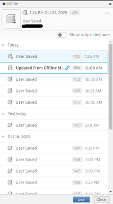

Got an issue in a design that I've been operating in for well over a year now.
Since October 16 2025, Fusion comes up with this error when trying to use the normal function of Update Components:
"Cannot Update components
Could not download latest referenced files. No content available"
I've never seen this error before.
I cleared the cache, tried a few other things, and simply cannot get it to update my components.
However, if I right-click on the external component, select "History", then "use" the most recent version, then it will update that way. I'm glad that this works, however it is going to be very annoying if I will need to do this workaround for very long since I can only update 1 component at a time this way.
I did confirm that it is only doing it on this one design. Why? No clue. The fact that it CAN update the references one way and not another suggests a glitch in the system.
Thanks for any suggestions. Here's a few screenshots:

Thank you @CMCORE , those logs have more info. There is a particular file that I'm thinking is causing the problem.
20251024T055957 E  27120 CONTENT_NOT_AVAILABLE for 8" IBEAM TONGUE
Do you ever see this error?:
Design not yet available - "8" IBEAM TONGUE v153" is currently unavailable to download. [User's name] saved the design, but their upload may not have finished. If [User's Name] closed Fusion, the version they saved will finish uploading when they open Fusion and connect to the internet on the same computer. - Click here to view error message.
This file is marked as 'content not available' which means that particular version didn't fully upload. Can you try the following:
  1. Have the other user who edited IBEAM TONGUE recently open it
  2. Get All Latest in this design
    1. There is a 'removed' linked component that is also out of date here. That file is titled "RJP...." and in order to bring it to latest, you'll need to scrub to that location in the timeline, GAL, then roll to the end again.
  3. Toggle the visibility of the root component off/on
  4. Save IBEAM TONGUE
  5. Try and GAL in the top level assembly again.
If that doesn't do it, capture diagnostic log files again and share them with me please 🙂

I never saw that exact error, although I do remember seeing an error with the first part of that message, saying that that part was "not yet available". At the time, I didn't quite put two and two together.
Lo and behold, I looked at that part you pointed out, and turns out there were 3 versions from 10/16/2025 from 2:14pm to 2:17pm that had saved but never uploaded and were unopenable. I opened the last version that could be opened (from 7/13 unfortunately), saved as latest, and now the issue is cleared up! Not totally sure why those versions did not fully upload and could not be opened, but fortunately the changes that were made were insignificant.
